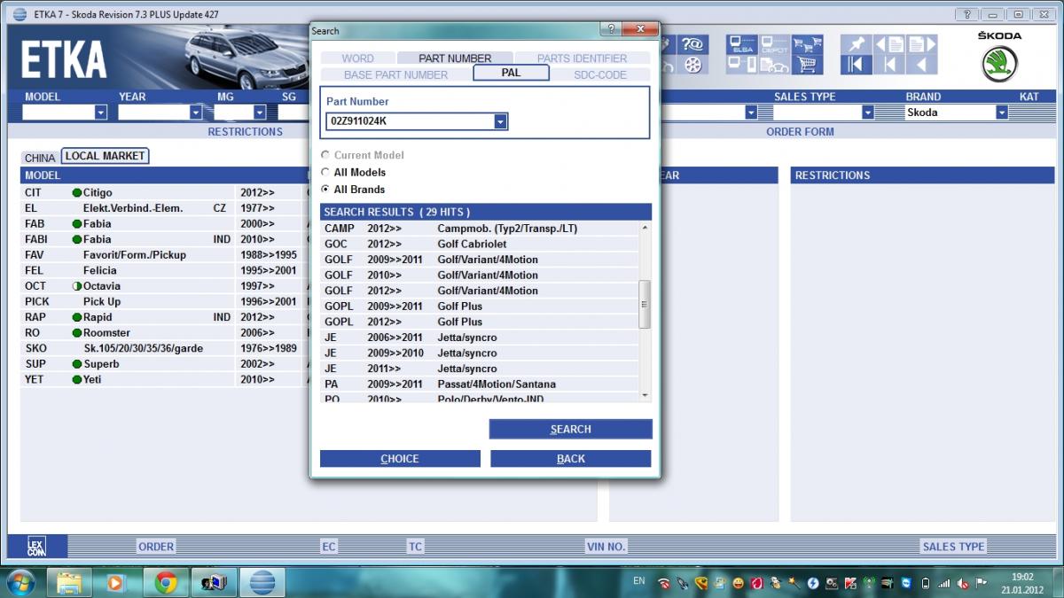

Imi poate spune cineva pe ce masini merge acest cod de electromotor
02Z 911 024K si care ar fi apx pretul unuia nou

Electromotorul valeo e pt masini de fabricatie recenta..pana in 2 -3 ani..in 5 minute revin cu lista de masini compatibile.
Da este electromotor pe original.
CAm pe toate:

cam pe toate Al dar nu si pe skoda mea din 2000 :)
VW - GOLF VI (5K1) - 2.0 TDI 10.08- - 81 110 1968
VW - GOLF VI Variant (AJ5) - 1.6 TDI12.09- - 66 90 1598
VW - GOLF VI Variant (AJ5) - 1.6 TDI 07.09- - 77 105 1598
VW - GOLF PLUS (5M1, 521) - 1.6 TDI03.09- 05.09 77 105 1598
VW - GOLF PLUS (5M1, 521) - 2.0 TDI 01.09- - 81 110 1968
VW - GOLF PLUS (5M1, 521) - 2.0 TDI 16V 01.05- 01.09 103 140 1968
VW - PASSAT (3C2) - 2.0 TDI11.08- -07.10 81 110 1968
VW - PASSAT Variant (3C5) - 2.0 TDI11.08- -11.10 81 110 1968
VW - POLO (6R_) - 1.6 TDI 06.09- - 55 75 1598
VW - POLO (6R_) - 1.6 TDI06.09- - 77 105 1598
VW - MULTIVAN V (7HM, 7HN, 7HF, 7EF, 7EM, 7EN) - 2.0... 09.09- - 62 84 1968
VW - MULTIVAN V (7HM, 7HN, 7HF, 7EF, 7EM, 7EN) - 2.0...09.09- - 75 102 1968
SEAT - IBIZA V (6J5) - 1.6 TDI 05.09- - 66 90 1598
SEAT - IBIZA V (6J5) - 1.6 TDI 05.09- - 77 105 1598
SEAT - IBIZA V SPORTCOUPE (6J1) - 1.6 TDI 05.09- - 66 90 1598
SEAT - IBIZA V SPORTCOUPE (6J1) - 1.6 TDI 05.09- - 77 105 1598 SKODA - OCTAVIA (1Z3) - 1.6 TDI 06.09- - 77 105 1598
SKODA - OCTAVIA Combi (1Z5) - 1.6 TDI 06.09- - 77 105 1598
VW - CADDY III Estate (2KB, 2KJ) - 1.6 TDI 08.10- - 55 75 1598
VW - CADDY III Estate (2KB, 2KJ) - 1.6 TDI 08.10- - 75 102 1598
VW - CADDY III Box (2KA, 2KH, 2CA, 2CH) - 1.6 TDI 08.10- 55 75 1598
VW - CADDY III Box (2KA, 2KH, 2CA, 2CH) - 1.6 TDI 08.10- 75 102 1598
VW - GOLF VI (5K1) - 1.6 TDI 02.09- - 66 90 1598
VW - GOLF VI (5K1) - 1.6 TDI 02.09- - 77 105 1598
VW - TRANSPORTER V Bus (7HB, 7HJ, 7EB, 7EJ, 7EF) - 2... 09.09- - 62 84 1968
VW - TRANSPORTER V Bus (7HB, 7HJ, 7EB, 7EJ, 7EF) - 2... 09.09- - 75 102 1968
VW - TRANSPORTER V Box (7HA, 7HH, 7EA, 7EH) - 2.0 TDI 09.09- - 62 84 1968
VW - TRANSPORTER V Box (7HA, 7HH, 7EA, 7EH) - 2.0 TDI 09.09- - 75 102 1968
VW - TRANSPORTER V Flatbed / Chassis (7JD, 7JE, 7JL,... 09.09- - 62 84 1968
VW - TRANSPORTER V Flatbed / Chassis (7JD, 7JE, 7JL,...09.09- - 75 102 1968

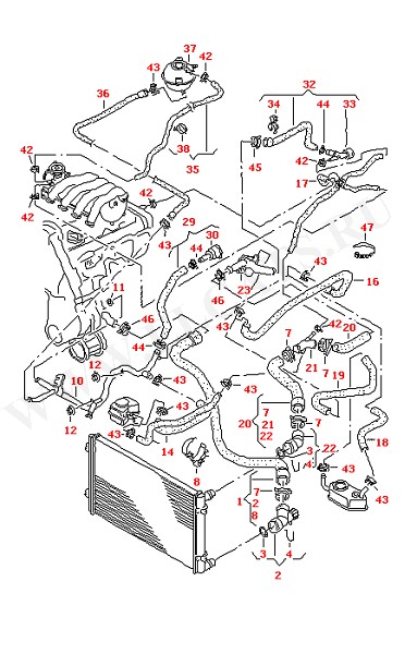

Salutare tuturor!
Zilele trecute am mesterit si eu la masina sa curat egr-ul insa am intampinat ceva probleme. Am reusit sa rup un prezon din suportul egr iar acuma am egr ul anulat pt a puteam merge cu masina. Am o mare rugaminte pt cei cu etka daca imi pot oferi ceva inf pt codurile reperelor urmatoare din poza de mai jos
Multumesc anticipat!
40-
38-
37-
35-
36-

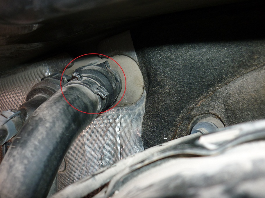

Salutare!
Ma poate ajuta cineva cu codul piesei de plastic de care sunt prinse furtunele inainte de a intra in radiatorul de incalzire?Initial am crezut ca furtunele vin prinse direct de tevile radiatorului,dar se pare ca mai e o piesa care are o garnitura,ceva.Pierd antigel pe acolo si as vrea sa o schimb.
Golf 4 ,2003, 2.0 benzina ,115 CP.
