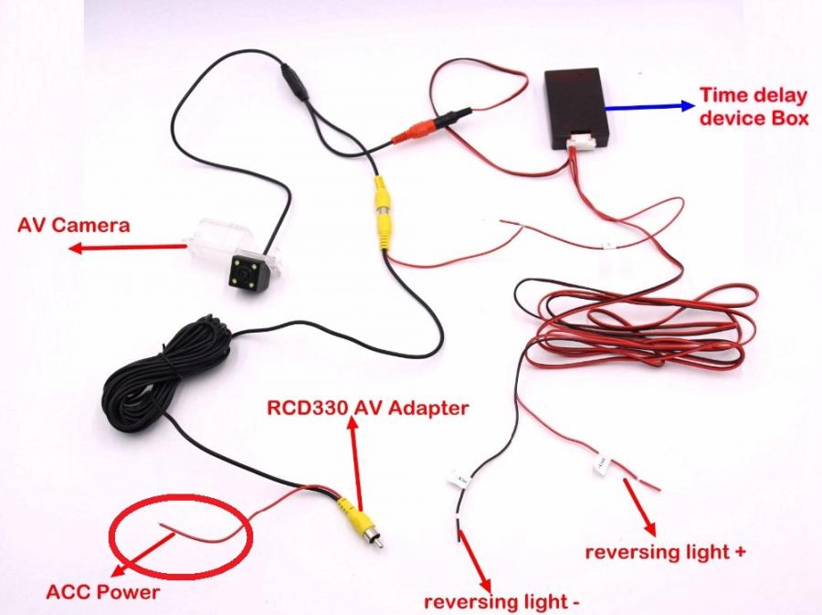

Installed this camera: https://www.aliexpress.com/item/Car-CCD-HD-520-TV-Night-Vision-Reverse-Backup-Parking-Waterproof-Rear-View-Camera-For-VW/32811829959.html?spm=a2g0s.9042311.0.0.T2sSik
I'm not sure about the wiring, because someone else did it, but from what I managed to see I think it is wired at a permanent 12V from the trunk. Camera is activated in VCDS.
My problem is that I also get the black screen, but only after two or three days of working just fine.
I went again to the guy and did some error erasing in VCDS and it started to work again, but the same, only for two or three days.
Camera has no problem, it works just fine on other monitors.

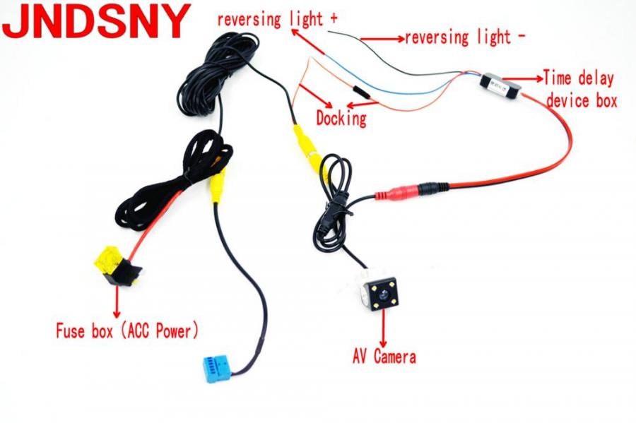

I also ordered this delay device relay, but haven't installed it yet: https://www.aliexpress.com/item/Car-Rear-View-Backup-Parking-Camera-Delay-Timer-Relay-Filter-for-VW-RCD330G-Plus-Passat-Tiguan/32808577617.html?spm=a2g0s.9042311.0.0.dj6T3V
Do you think I also need a quadlock adapter like this in order to make it work: https://www.aliexpress.com/item/RCD330-Plus-MIB-RCD330G-Plug-Play-ISO-Quadlock-Adapter-Cable-Wire-CANBUS-Simulator-For-VW-Golf/32833777033.html ?
Or is it enough to wire it like in this scheme?

Salut baieti! Tocmai ce imi cumparai camera de marsarier cu delay box din imagine pentru al meu passat b6 berlina din 2008 si nu vreau sa ma apuc sa o montez pana nu stiu toti pasii asa ca unde trebuie sa leg firul rosu ACC incercuit? De regula trebuie conectat la navigatie dar din moment ce RCD 330G plus nu vine cu firul reverse nu imi dau seama ce trebuie sa facut cu el. Si inca ceva, nu dispun de aparat de masurare si indentificare a firul "+" si "-", care dintre firele de la lampa de marasrier este plus si care este minus? sunt ambele de culoare maro si sunt numerotate cu 1 si 2 pe mufa de intra in bec
Eu am legat ACC la plusul de accesorii din mufa unitatii.
Minusul l-am identificat prin faptul ca la masina mea, pe placuta cu traseul pentru becuri, era comun pentru toate becurile.
Modificat de dionescux
