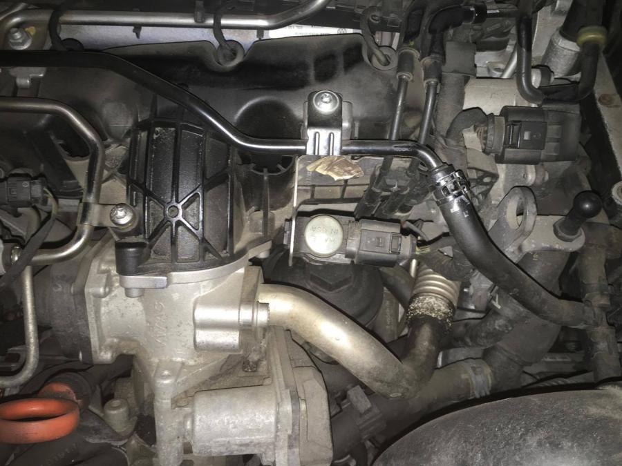

Am o problema la un golf plus 2.0 TDI CBDC, cu senzor G28 a dat o eroare de intermitent.
Imi poate spune cineva unde este pozitionat, ca nu gasesc. A mai dat eroare in primavara o singura data..si acum iar. Banuiesc ca e cablajul, dar as vrea sa verific.

Removing and installing engine speed sender
Removing
– Remove noise insulation. →General body repairs, exterior; Rep. gr.66.
– Clamp off coolant hoses from oil cooler with hose clips, up to 25 mm in diameter -3094-.
– Loosen spring-type clips -arrows- using spring-type clip pliers -VAS 6362-.
  Note
Collect escaping coolant with drip tray -VAS 6208-.
– Pull coolant hoses off oil cooler.
– Remove oil filter bracket → Chapter.
– Loosen securing bolt -arrow- (4 mm socket -T10370-) and pull out speed sender.
Installing
Installation is carried out in the reverse order. When installing, note the following:
l Specified torque for engine speed sender -G28- → Item
l Specified torques for oil filter bracket → Chapter.
– Check coolant level, replenish coolant if necessary → Chapter.
Multumesc pentru promptitudine :)
Deci e in zona aceasta, in spate la filtrul de ulei.
