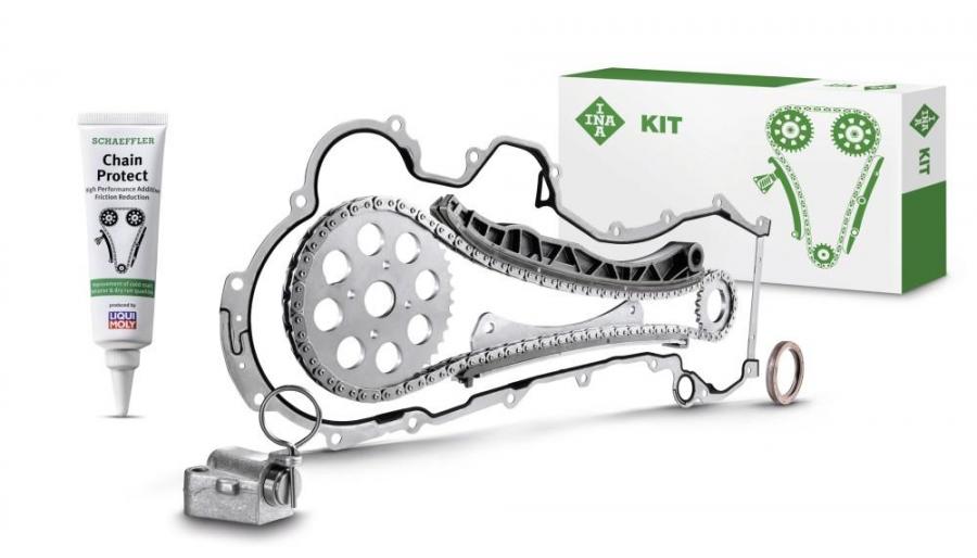

Buna ziua,
Cautandu-mi un set de distributie INA am dat peste urmatoarea informatie pe site-ul lor: https://www.schaeffler.de/content.schaeffler.de/en/news_media/press_office/press_releases/press_releases_detail.jsp?id=81026243
"For optimal lubrication and additional protection against wear, Schaeffler is including a chain additive with its INA Timing Chain KITs, effective immediately. This new product, developed by Schaeffler and the oil and additive specialist Liqui Moly, reduces running-in wear after chain drive replacement by up to 20 percent.
LANGEN, GERMANY, 30 January 2018. With this additive, Schaeffler and Liqui Moly are bringing a novelty to the automotive spare parts market. It was developed especially for timing chains, which must run dependably on a sustained basis under high load and engine speeds. Demands on timing chains are particularly high in vehicles that drive mostly short distances. A new chain system is usually installed in a worn-down, older engine environment with contaminated oil residues. And this is exactly what Schaeffler is addressing. Decisive factors for the long service life of the new timing chain – and with it smooth engine operation – are the replacement of the entire chain drive system, the use of manufacturer-specified oil and the additional reduction of wear from the new additive. “Mechanical wear, and chain elongation resulting from this, are caused mostly by inadequate lubrication, and can in a worst-case scenario lead to engine damage,” says Maik Evers, Director Program Management Extended Products at Schaeffler Automotive Aftermarket. “We have developed an additive together with Liqui Moly that counteracts this and offers extra protection against wear.”
At installation, the additive – based on the low-friction lubricant MoS2 – is applied to the chain and sprocket to create a heavy-duty lubricating film on all metal surfaces that rub or slide against each other. It reduces friction and guarantees smoother chain operation. This is especially beneficial when breaking in a new chain in an engine environment that is already broken in. It results in up to 20 percent less running-in wear of the new parts. The KITs also come with timing chains, chain sprockets, hydraulic and mechanical chain tensioners, tensioning and guide rails, along with the appropriate gaskets and all mounting parts needed for professional repair. The advantage of the KIT – by replacing the entire timing drive system, garages can avoid costly follow-up damage to the engine."
Se pare ca ei folosesc un aditiv LM pe baza de MoS2 livrat in kitul de distributie INA. Se aplica la schimbarea lanturilor de distributie ce direct pe pe lant la montaj pentru a se efectua corect rodajul lantului.
Poate ca nu ar strica celor care nu au facut asa un aditiv LM pe baza de MoS2 in ulei dupa ce se schimba distributia... dar nu stiu in ce masura e la fel de eficient sau daunator la catalizatoare sonde lambda...
Sa aveti noroc de distributii si sa va feriti de chinezarii no name (unii s-au fript).
