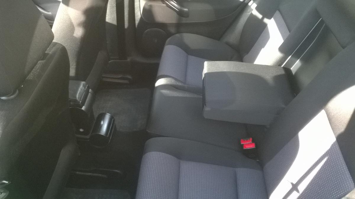

Si o poza cu interiorul:
post-145380-0-49358300-1421756462_thumb.
post-145380-0-13056100-1421756463_thumb.
post-145380-0-60772600-1421756463_thumb.
post-145380-0-68314900-1421751472_thumb.
