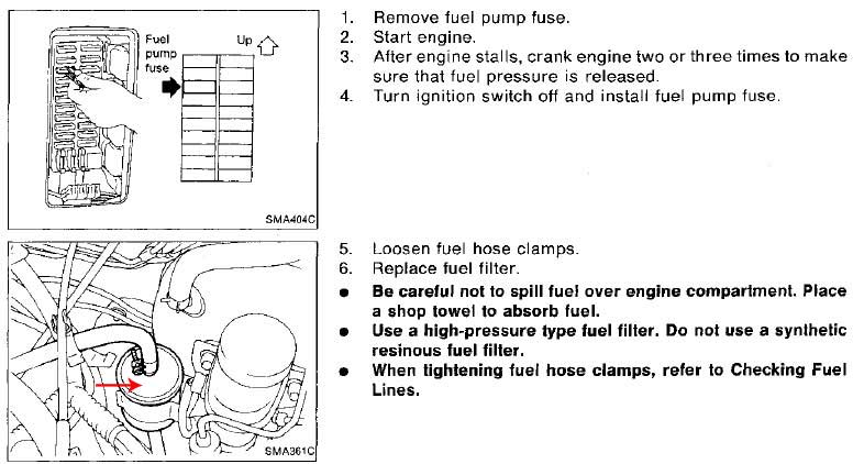

inainte de toate...desfa un filtru dupa 30-40-50 000km..si vezi cum arata
uite de la alti producatori
http://www.aveoforum.com/forum/attachments/f94/5098d1323548904-fuel-filter-change-aveo-sedan-2010-lt-manual-cambio-filtro-gas-jpg
http://www.andrews.edu/~vorostse/fuel_pump.jpg
http://www.crvownersclub.com/forums/attachments/maintenance-service/13218d1384711855-location-fuel-filter-2011-crv-ff.jpg
http://ww2.justanswer.com/uploads/oldnewenglandmarine/2011-08-30_205147_6lyfuelfilter.jpg
http://www.dieselfiltersonline.com/Diesel-Filters-Spec-Sheets/Ford-Recommended-Oil-Fuel-Air-Filter-Replacement-Intervals.gif
http://www.cars101.com/subaru/maintenance2012c.JPG
citeste si textul din cartile de service de mai sus.
si daca vrei iti pot pune 100 de linkuri.
daca nici dupa asta nu ai inteles...eu nu mai zic nimic.
