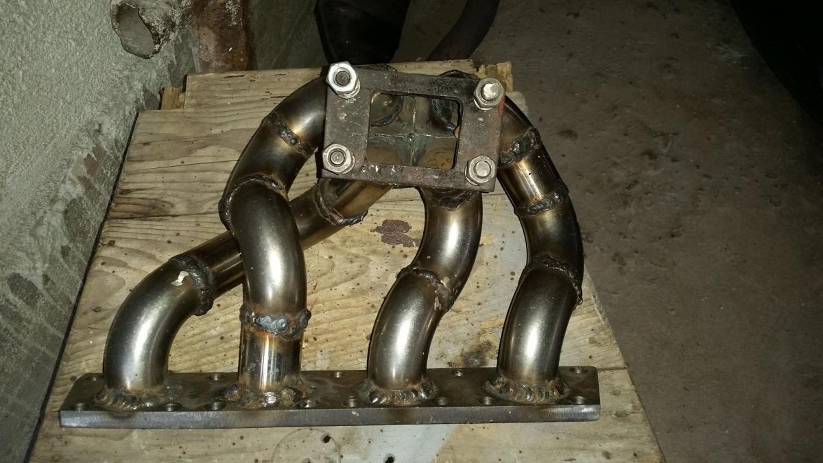

TurbO T3:
COMPRESOR
-.42 AR
-inducer 44.4mm
-exducer 60mm
TURBINA
-.48ar
-inducer 60
-exducer 48mm
BLOC MOTOR STOCK....
-Serpisori de aceeasi lungime,fara colector.
-downpipe 70mm inox catless
-evacuare 70mm inox,din 2 bucati
-toba JOm 65mm ( nu e ceva firma smechera dar isi face treaba ffff bine , si sunetul e demential)
-pompa benzina INTANK AEROMOTIVE 360LPH
-regulator presiune 4bar stock
-injectoare BOSCH 510cc/4bar
-filtru benzina MAHLE high flow
-bobine 2l TFSI/TSI/R8
-bujii NGK cu un grad mai reci ( normale,regapate)
-blow off HKS ssqv 4
-electronica de euro 4+bord e4
-cuple samco si turboworks

Pe viitor: cuzineti ACL,biele Eagle,suruburi ARP,garnitura multilayer otel cu decomprimare,turbina ( ma mai gandesc la model),cutie 1.9tdi
