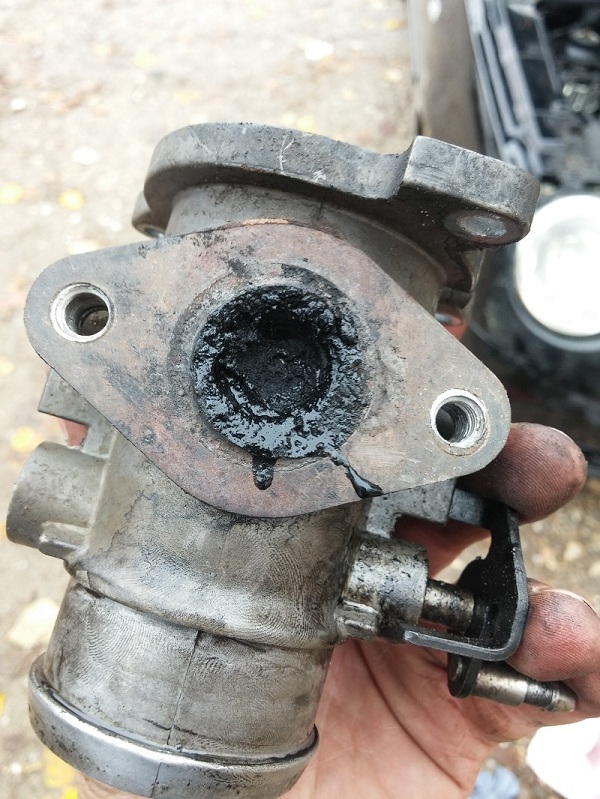

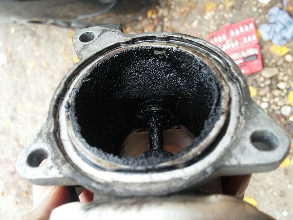

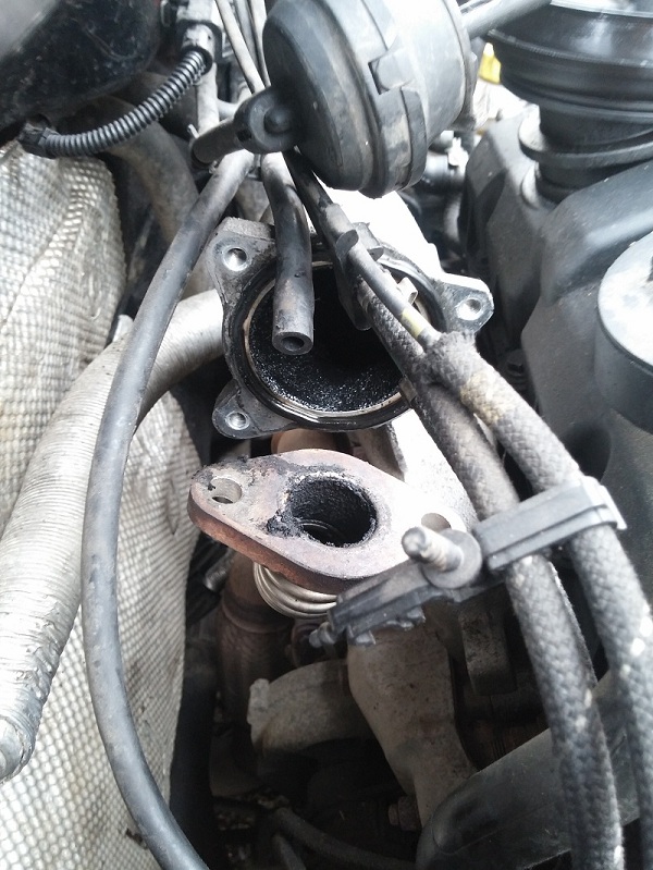

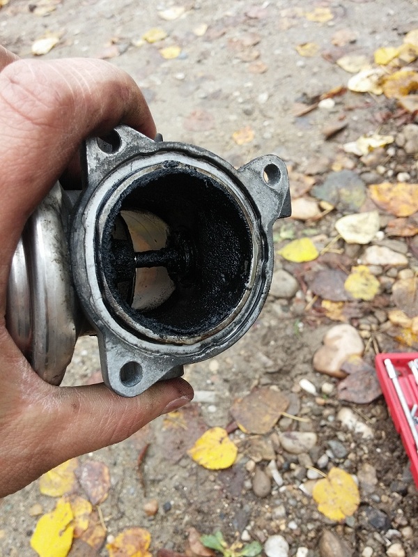

Am curatat si eu astazi EGR-ul... cam asa arata ...
post-142331-0-78249900-1416403323_thumb.post-142331-0-31449900-1416403324_thumb.post-142331-0-71177300-1416403324_thumb.post-142331-0-01778200-1416403325_thumb.post-142331-0-47544800-1416403325_thumb.
Si dupa doua ore de munca ...
post-142331-0-49760900-1416403352_thumb.
Se simte ceva la mersul motorului?
