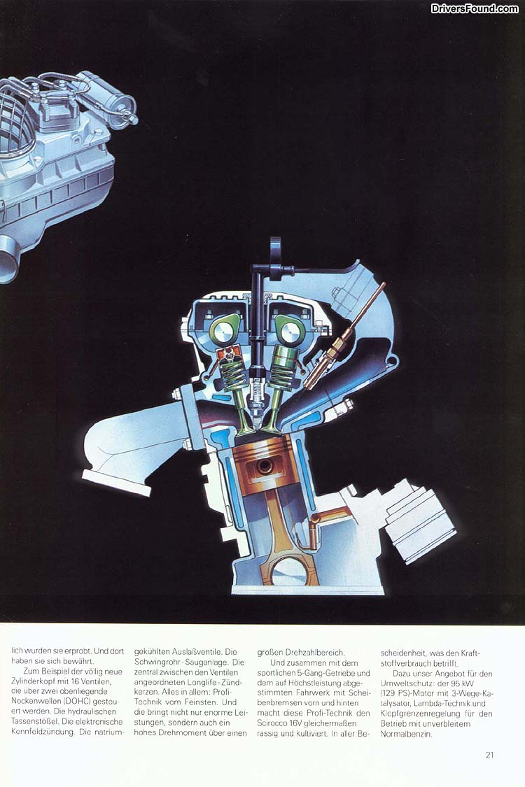

16v:
http://www.driversfound.com/scirocco/histo...german1987t.jpg
http://www.driversfound.com/scirocco/histo...german1987u.jpg

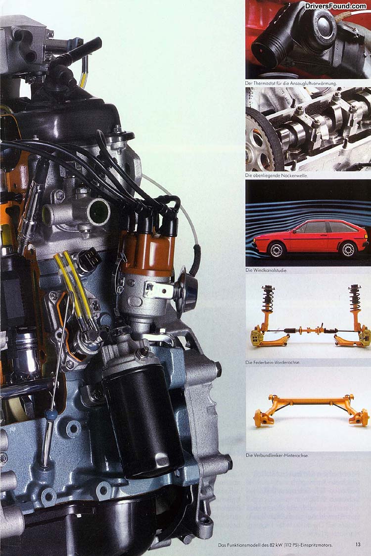

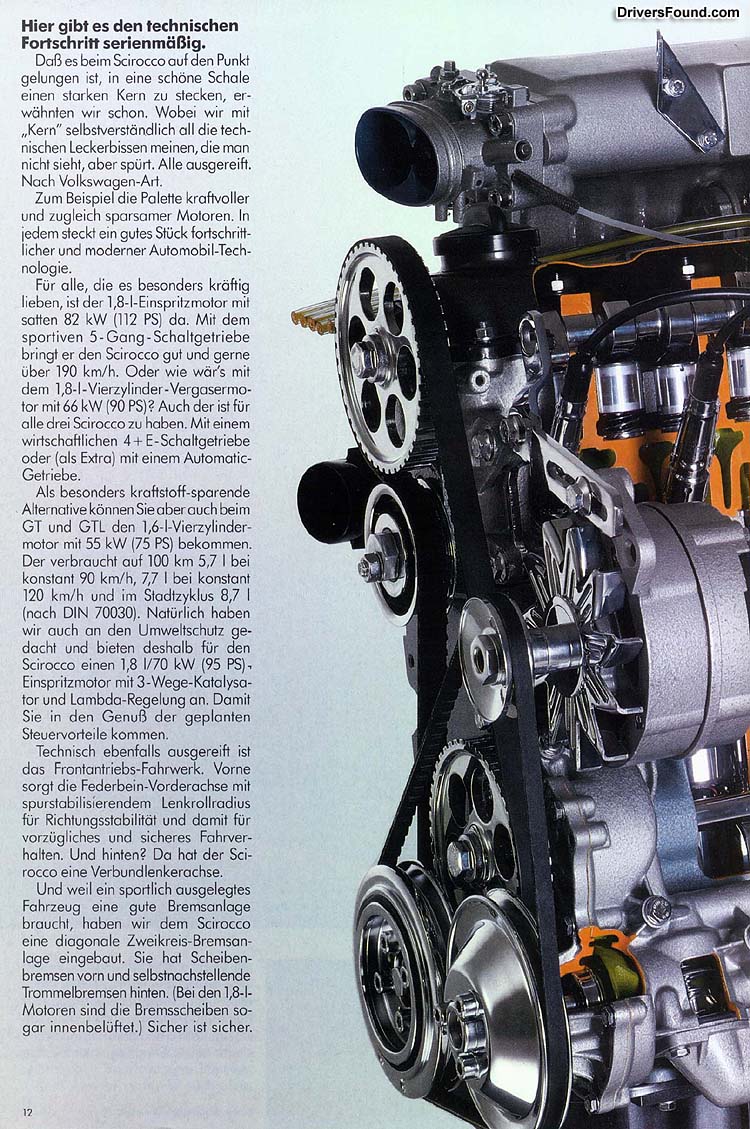

8V:
http://www.driversfound.com/scirocco/histo...german1986l.jpg
http://www.driversfound.com/scirocco/histo...german1986m.jpg
