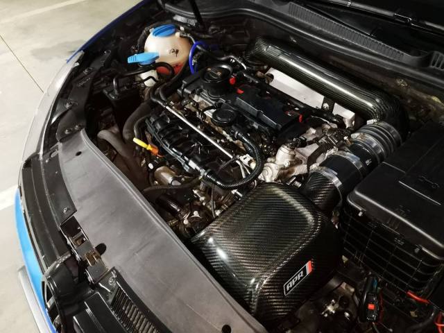

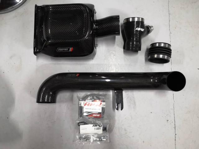

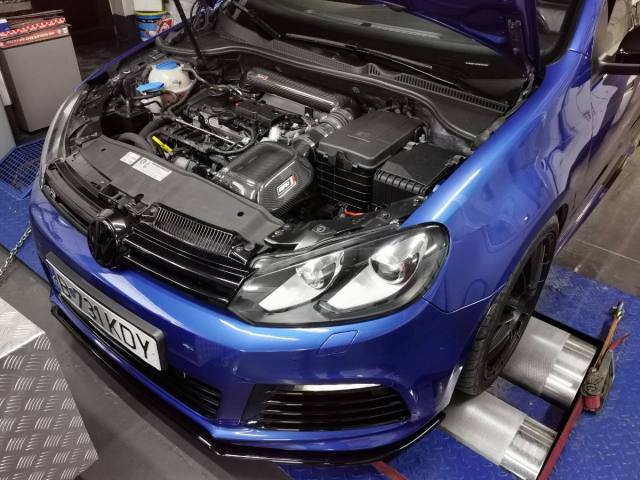

Ne pregatim pt stage 2+. Admisie 'cold air intake' Ramair Oversized
Edited by keddy_net
Link to post
