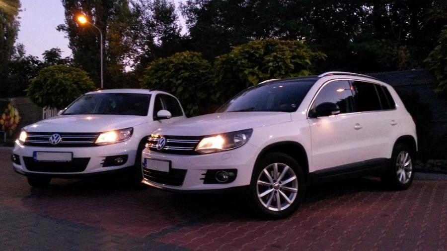

Perfect de acord...arata mult mai bine fara folie pe eleron.
Niste geamuri negre ar completa si mai bine look-ul, ce zici? :cool:
P.S. dragut Golf-ul ala de langa tine :P
Vin si geamurile... la timpul lor.

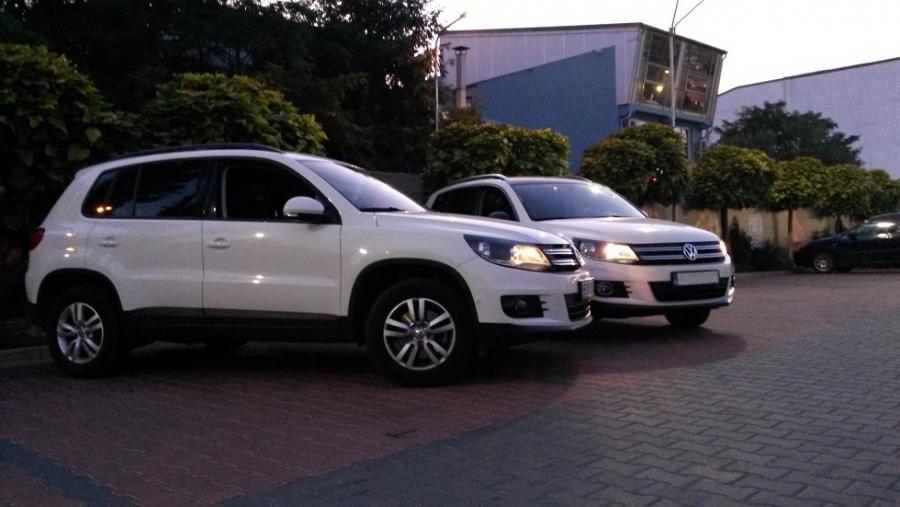

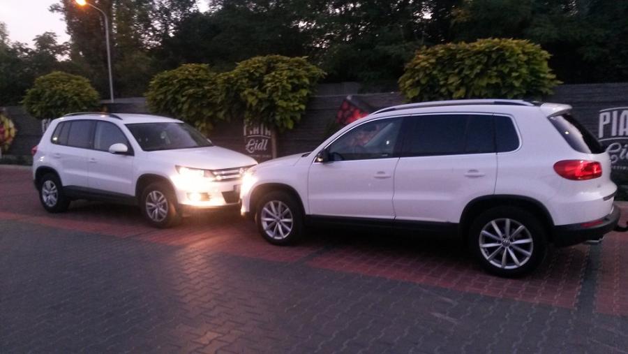

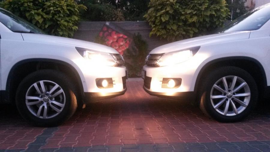

Sa vezi ce coincidenta....:)20170720_000606.thumb.jpg.6b1aa17cac1a5b0096ad3c4f8f0a95ad.jpg20170720_000646.thumb.jpg.bc2c8d4599296e48e6eb9c37c7e702cb.jpg

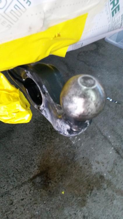

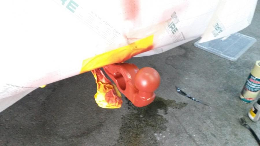

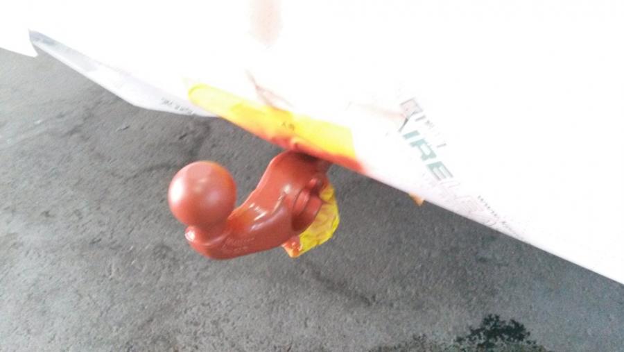

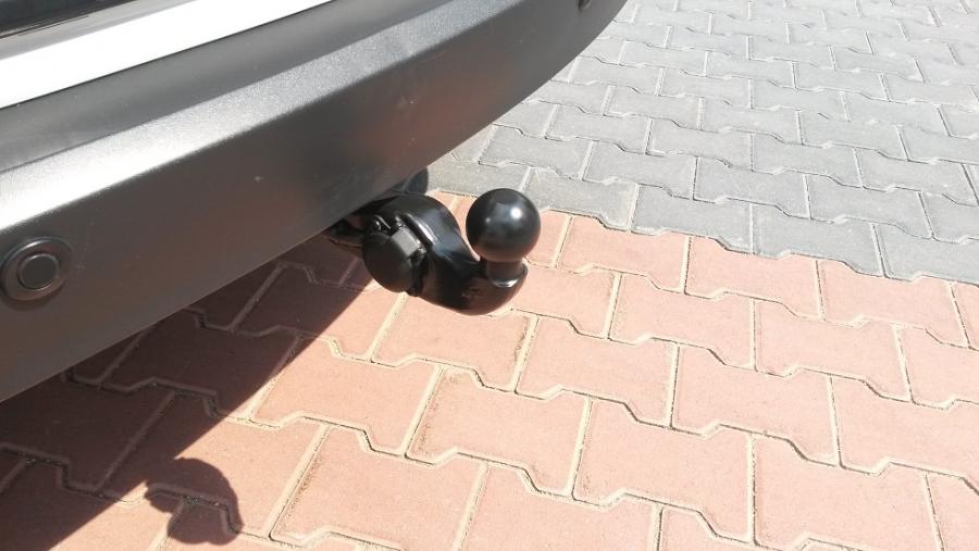

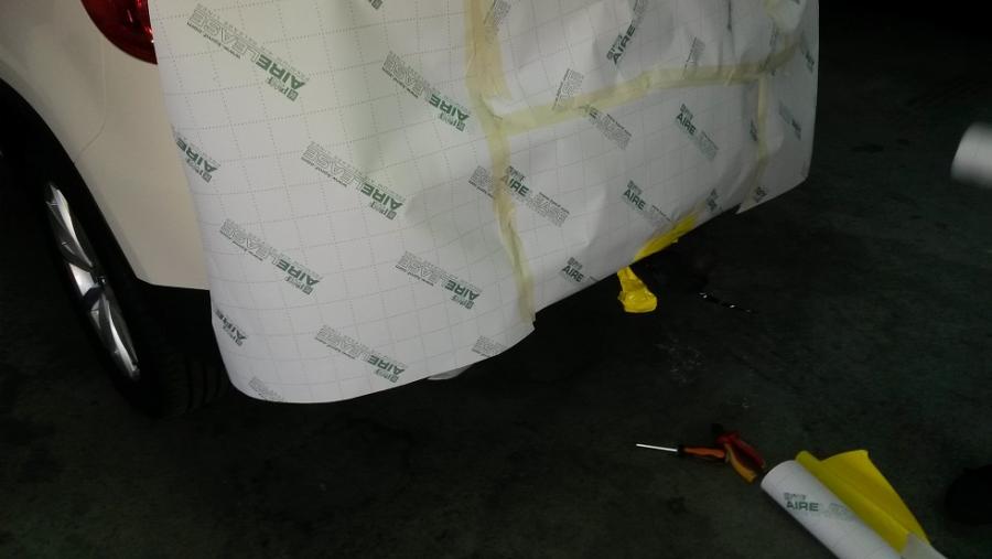

Am rezolvat doua detalii, zic eu, de efect.

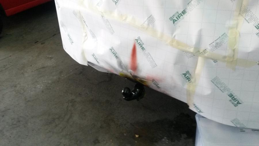

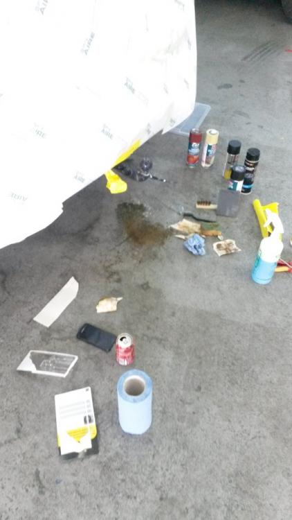

1. Revopsirea carligului de remorcare (curatat bine, aplicat un agent chimic de neutralizare a riginii, aplicat grunt anticoroziv, si in final vopsit - negru semi mat)
20170720_105007.thumb.jpg.c126e9d754bf357fe6513e187bc4b0d8.jpg20170720_104945.thumb.jpg.4affe60e10951ac09833d27ffe2bc386.jpg20170720_110752.thumb.jpg.889a7392afc3e3a2ac5660b6bc75bb5f.jpg20170720_113321.thumb.jpg.356bd7d1c4b99bf89bc4a2cb6b10a299.jpg20170720_120141.thumb.jpg.77b3ce655fb97f8858f5eca8a0fead36.jpg20170720_120146.thumb.jpg.b8872db1d5885591bcdef5f88dd155d9.jpg20170720_141752.thumb.jpg.7b084f0b2ec22d833e60bff81d718a84.jpg

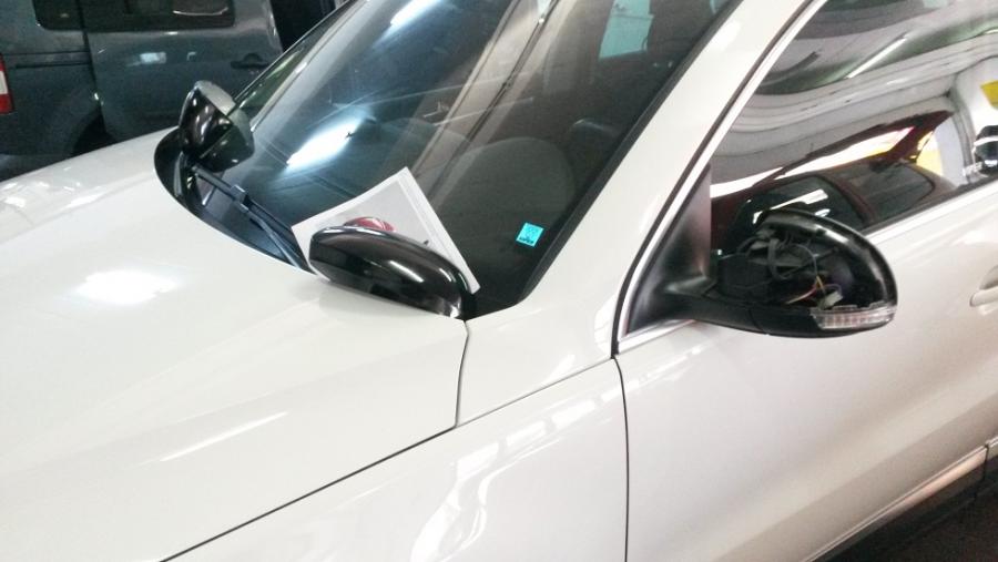

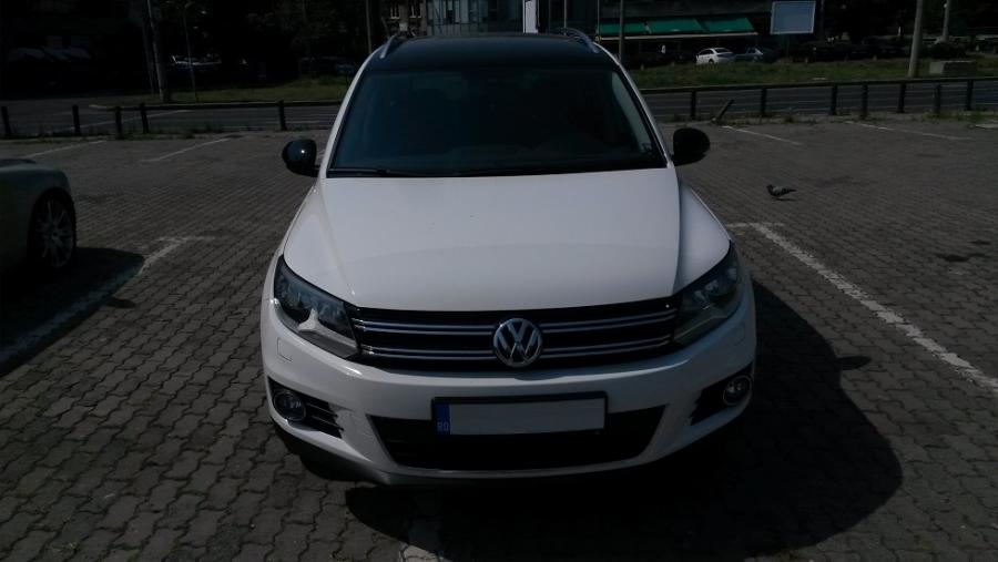

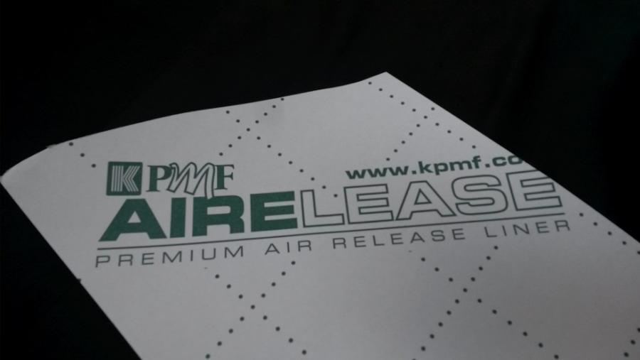

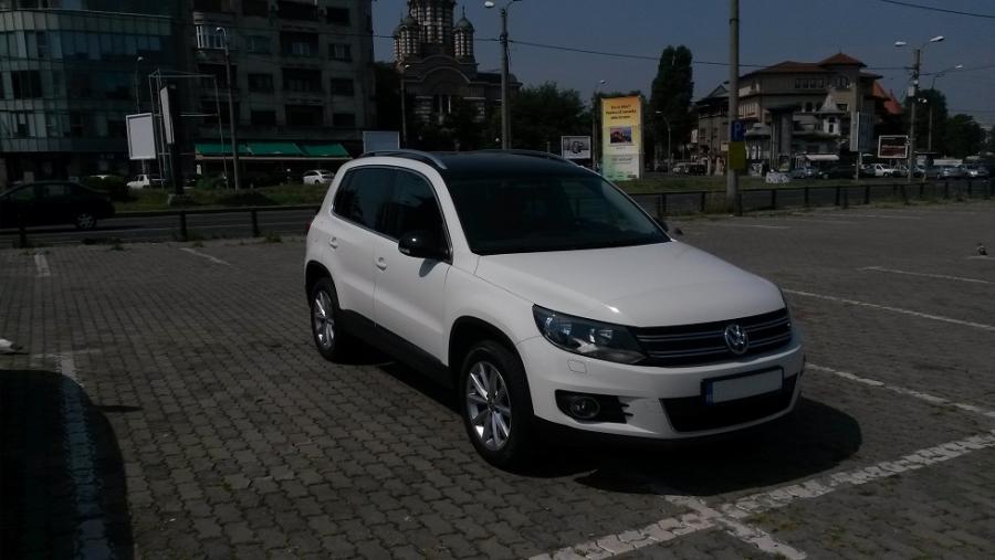

2. Colantare oglinzi cu folie KPMF  AireLease, negru lucios. Din punct de vedere vizual, nu exista diferente fata de cea de pe cupola.
20170720_115708.thumb.jpg.5355b886755e865a73ce5b2236b12b4a.jpg20170720_130500.thumb.jpg.7cab068e64896a1713f82bae4f99081b.jpg20170720_141736.thumb.jpg.2d9e734fc8a07aec09842805c1f8eefb.jpg

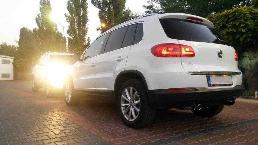

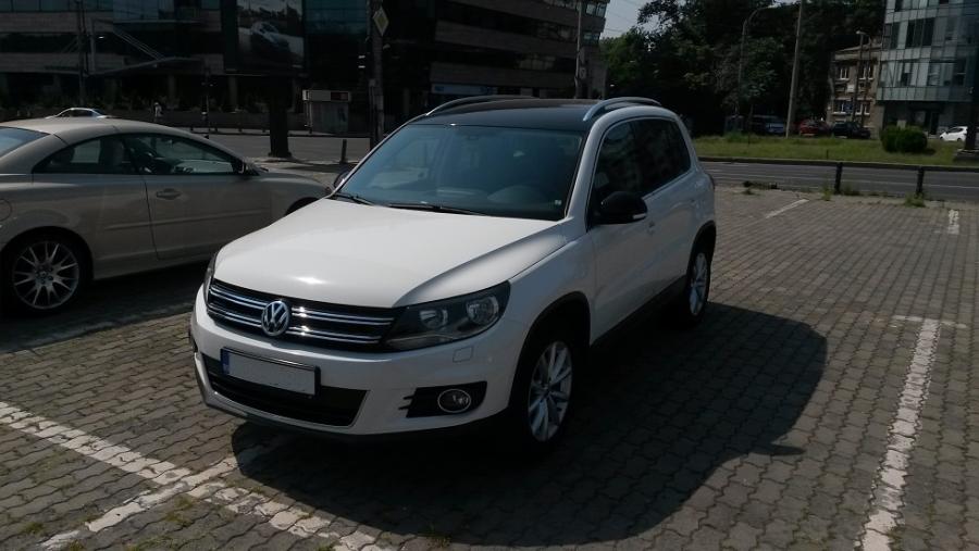

Rezultat:
20170720_152759.thumb.jpg.091f487a6b1e835c896edd3ff368c500.jpg20170720_152805.thumb.jpg.f38b244794f538522a8251b7887428ee.jpg20170720_152812.thumb.jpg.f9f5510e4cd83cbae2665a4ac2f9edc9.jpg20170720_152833.thumb.jpg.8884e6fd8c5eba6af61a5eb5ea1a6745.jpg20170723_110451.thumb.jpg.af9ad6e810f068060bec3fa0538971a5.jpg20170723_110459.thumb.jpg.b1bb84dfce7b7662659af3166e776c7c.jpg20170723_110533.thumb.jpg.4cfa22380117e0fcb18c0770d1a49507.jpg20170723_110543.thumb.jpg.af4dc2854d888af4f152c9b7bbca473f.jpg20170723_110553.thumb.jpg.4424ca3f372788f49f56c4d421a3ff30.jpg20170723_110607.thumb.jpg.4fc38baaa5d4ca7c00350d0e46ba0763.jpg

Misto detaliul cu vopsitul carligului. Chiar daca era doar defect estetic si nu unul functional, e de mare efect felul in care arata acum. Like :icon_thumleft:
Detaliaza te rog - "agent pentru neutralizarea ruginii". Am luat pentru Bora carlig de remorca sh, si vreau sa il fac gigea inainte de montaj. Merci :)
E o solutie care se aplica cu pensula dupa curatarea mecanica. Daca raman urme foarte mici de rugina, solutia respectiva o neutralizeaza (are loc o reactie chimica care transforma rugina in ceva negru si dur - se vede in poza), spre deosebire de un decapant care ataca rugina si o curata, dar in acelasi timp este coroziv si pentru metal. Evident ca ideea procesului e sa nu reapara in timp rugina sub vopsea. Solutia respectiva a fost de ajutor in conditiile in care, carligul a fost curatat cu smirghel. Daca se folosea o perie mai dura de sarma probabil curata mai bine si mai usor rugina dar ar fi zagariat metalul.
In cazul tau, ti-as recomanda sa sablezi carligul si sa il vopsesti electrostatic. Eu nu am facut-o pentru ca am carlig rabatabil si am considerat ca nu a meritat deranjul sa il demontez.

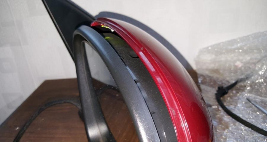

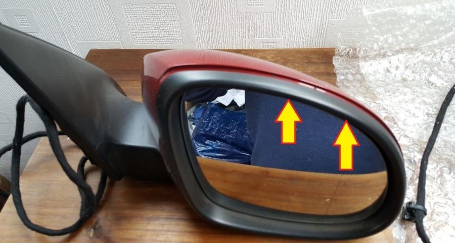

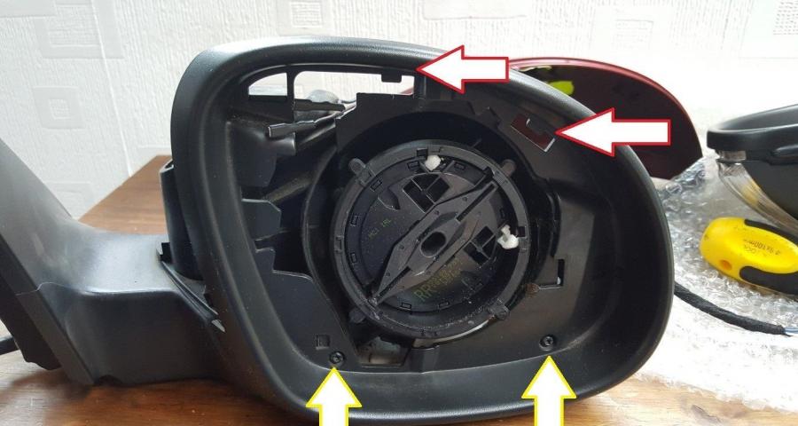

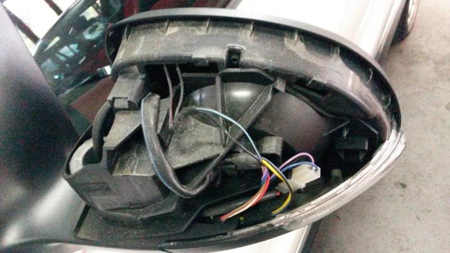

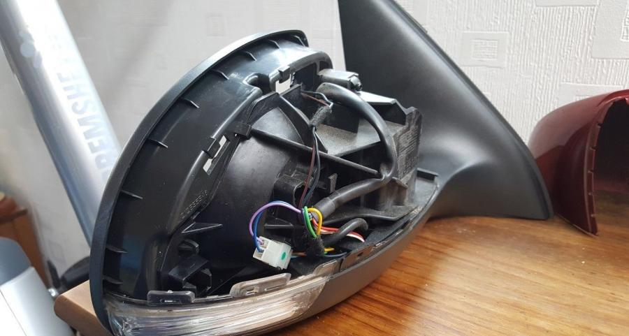

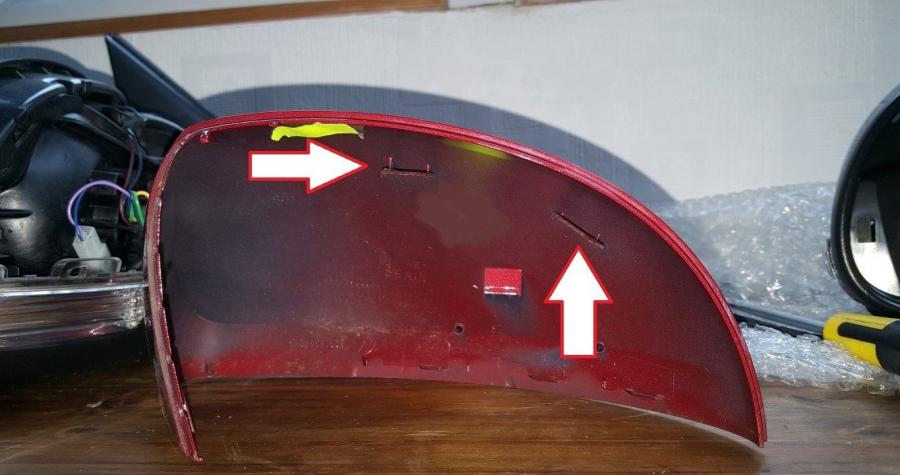

Cum ai scos oglinzile? Ca as umbla si eu la becuri.
Foarte frumos a iesit, continua te rog, ca sa am si eu inpiratie :D. Acum pare mai "intreaga" cu oglinzile la fel ca si tavanul.
Eu nu le-am demontat complet asa ca iti spun ce stiu: Din ce am inteles, procedura la Tiguan si Sharan e diferita fata de cea de la Golf; Passat &co. Carcasele se dau jos primele, fara a demonta oglinda. Ca procedeu: se regleza oglinzile la maxim in jos. In partea de sus, se pot obseva doua cleme in forma de U care trebuie impinse in jos cu o surubelnita mica.
DIY2.thumb.jpg.1cd20c2d9e26d241dca03d7e321b1133.jpgDIY3.thumb.jpg.6afdb4135dfc495be839112ff66005ec.jpgDIY1.thumb.jpg.e986dadd16f9a01ac12bd469c68065fd.jpgDIY5.thumb.jpg.c119a3831418e0af97118aecb2212465.jpg
Apoi carcasa se impinge usor spre inainte si  iese cu un pic de trosnet care in prima faza m-a ingrijorat dar totul a fost ok.:P
Dupa asta cred ca se demonteaza sticlele ampingand prin gaurile unde erau calmele de la carcase, dar asta e din ca am citit, nu am incercat. Mai derparte nu stiu, doar imi imaginez ca nu e foarte complicat.

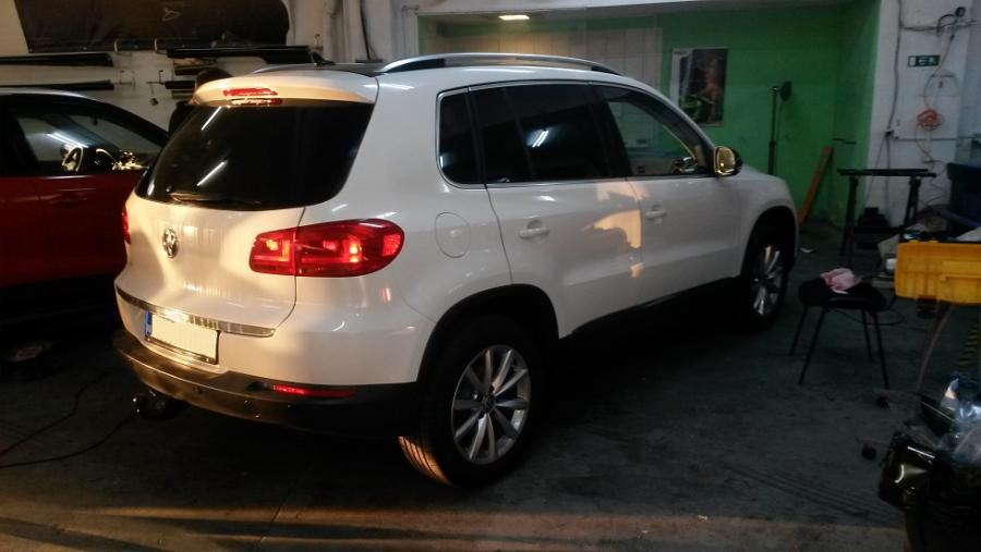

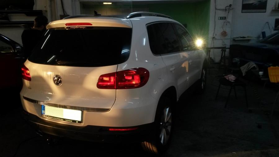

Era inevitabil... folie Llumar ATR.
Am fost foarte nehotarat in aceasta privinta dar acum nu regret deloc. In acelasi timp ma bucur ca nu m-am grabit. Mi-am dorit mult o aplicare la un inalt standard calitativ si spre satisfactia mea am obtinut asta.:)
20170915_184613.thumb.jpg.4d87efea015651c13d11819b4a28e2d6.jpg20170915_184622.thumb.jpg.2126a3e4f60a3042afb5863c8cb29bb6.jpg
